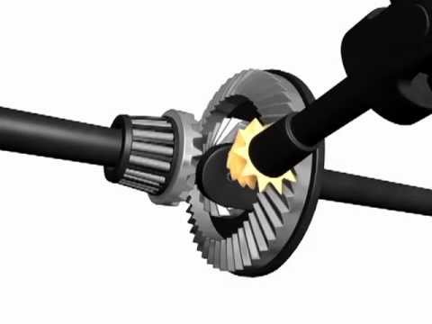

    I'm not quite sure what you need help with so I will guess. I think you are asking how to determine what speed to use for each of the two drive motors based upon the angle of the steering. For a right turn the left motor will turn faster than the left. You will have to measure the turn radius and calculate the difference that each wheel has to travel for a given turn setting, then drive the motors appropriately.
    You probably know but in a car one motor drives both drive wheels via a differential - which automatically divides the power between the wheels.
  • W9GFOW9GFO Posts: 4,010
    edited 2012-10-24 18:53
    It really is a good tutorial on differentials;
    edited 2012-10-24 18:59
    Here's a video from 1937 that explains the automobile differential in the simplest terms possible:
    edited 2012-10-24 19:02
    I think that is the exact same video but with a different title. I agree that it is a very good explanation, I wish there were more videos like this.
    edited 2012-10-24 19:22
    Ah, you snuck that one in ahead of me! I was responding to #3. :)
