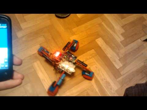

    Well honestly If i could really get build a heavy duty robot that can roll around the desert and mountains untended I would want to use some fairly large wide wheels, The idea would acually be to mix a 4 legged walker with a wheeled bot so it could climb things in its way. The bot would have for independent motors/servos/steppers etc.. at the "feet" this would be its main travel system. It would only walk to climb things and get unstuck. This bot would be a huge challenge but I think it would be the design I would really love to build the most. One of my issues is I dont know what the wheel set up is even called to do a little more research on it, I mean I understand how it works how to gear etc, but id like to know some more in depth info. And actually the more I think about it the leg joints might need pretty hi torque two, but they would need acuracy. lets say the thing weighed 20 libs and lets say each joint was 2 or three lbs stepper or servo which is more cost effective and effiecent.
    Here is an example where i drew insperation from..
    http://letsmakerobots.com/files/field_primary_image/Stair_Climber_3.jpg
    A
    nd here is my idea
    If someone could tell me what that sort of wheel set up is called id appreciate it
    1024 x 768 - 59K
  • W9GFOW9GFO Posts: 4,010
    edited 2012-10-21 23:57
    Here's a similar robot;
