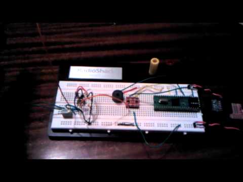

A few years ago I saw this PDF http://thereminvision.com/version-2/ThereminVision-II-manual.pdf which on page 20 contains a schematic for a 555 oscillator, a circuit to compare the oscillator output against a reference frequency, and a circuit to shift it into the audio range. It is supposed to be used as a proximity sensor for a BS2 robot. It occurred to me that a Propeller chip could do most of the signal measurement and audio output, so I would only need the 555 timer oscillator to do the same.
Well the 555 timer has been sitting in my parts box for the better part of a year, but tonight I finally built the oscillator, used a propeller chip to measure the reference frequency, and a piezo speaker to output the results. Here's a video of the result:
The piezo speaker is quiet, but you can hear the change in pitch as I move my hand. The propeller code to do it is easy using the BS2 functions.

    Using a prop as the reference frequency generator and signal processor is a great idea. Using a 556 with 2 capacitor plates would allow both frequency and volume control. Have to give that a try if I ever get the time.
