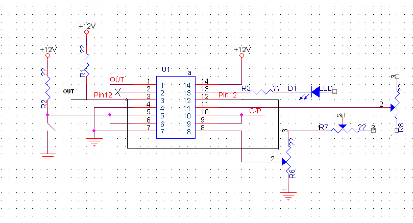

I have been trying to repair an instrument and i am unable to identify a 14 pin chip.
I am attaching an image of the connected parts to this chip.
If someone could give me some pointers , i would be extremely glad

    Welcome to the Parallax forum! What a great puzzle! My knee-jerk first impression was a 556, but the pinout just doesn't jibe. Another was a quad op amp. Though a tantalizing possibility, the pins aren't in quite the right order for that, either.
    edited 2012-10-12 00:43
    Two clues in the schematic make me feel this is a prank.
    First, the power to the chip is +12 volts. There are logic chips that will accept this, but most are +5 or +3.3 these days.
    Second and more importantly, there is a potentiometer in series with a second potentiometer that appears to do nothing.
    That second item will either define this a genuine or prove this is nonsense. There are very few good functional schemes where two potentiometers are in series. So what is the purpose of that. And why not just have a resistor for the second one that appears not to use the adjustment on it?
    The fact that there are no values and all devices are either resistors or switches makes me wary. One has to decide at some point if the chip is digital, analog, or hybrid.
    I suppose one could investigate by trying to create a template of all 14 pins - two are power, and the others would all be either inputs, control, or outputs.

    The IC could be something like a 74LS107 Dual Negative-Edge Triggered Master-Slave J-K Flip-Flops.
    This chip has the clock triggering occurring at a voltage level so the pots could set the voltage level....

    So one pot would be 'rough tune' and the other would be 'fine tune'. But a 74LS107 requires less that 7 volts.

    Any of the 4000 series logic chips are fine at 12 volts. It'd also be nice to have a closeup picture of the chip where it's installed. If your camera won't focus with a close enough shot to get details of the chip label, a hand magnifying glass works just as well for a camera as it does for your eyes.
    Lawson
    edited 2012-10-12 08:36
    Pins 8, 9, and 10, suggest an op-amp unity gain voltage buffer: pot and trimmer connected to positive input, output connected to negative input. Pins 11, 12, and 13 suggest a comparator-type hookup: threshold set with positive input, negative input coming from pin 3 side, output driving an LED. Pins 1 through 6 are a mess, though, and don't conform to any known op-amp pinouts. abicash, are you sure you traced that part of the circuit correctly?

    Can we narrow it down by elimination?
    First of all it isn't a hex buffer or inverter as those have 6 pairs of i/0 and two power lines - a 16 pin dip.
    It is not a standard op amp chip (or is it)
    It is not a UNL darlington array as those have all outputs on one side and all inputs on the other.
    It could be a logic chip with multiple inputs and a sign output of some sort and multiple.
    Lets see. 14 pins minus two for power leaves 12. Either 3 devices or 4 devices or 2 devices.
    3 devices of 3 ins and 1 out
    4 devices of 2 ins and 1 out
    2 devices of 5 ins and 1 out
    Or 6 device of 1 in and 1 out. ? Wait a second I said that a hex device requires 16 pin dips. I made a boo-boo.
    edited 2012-10-12 11:17
    It's definitely not purely digital. You don't attach pots to gates. 'Might be mixed-mode, as suggested by the pull-ups, but the lack of caps tells me that it's not a timing chip of some sort.
    edited 2012-10-12 11:23
    I am back to my first impression, a hoax.

    Or, it may be incomplete or not entirely accurate. If the existing part is soldered to the board then there may be hidden traces underneath, etc. Could be that 12V is a guess on the supply voltage. We could use some more details. What is the instrument? Is a custom home brew design or something more finished? What is the model #? Can the person provide any pictures? Close ups of the chip and board would help. Are there any markings on the chip or was it all sanded off to hide it?

    Perhaps it is a comparator of sorts with a latch function (reset pushbutton maybe)?

    The button controlling pins 5 and 6 strongly suggests one of the CMOS analog switch chips (selecting between different voltages to output on pins9&10, but not all the other connections make sense
    It's not a CD4051, '4052, '4053, or '4016/4066.
