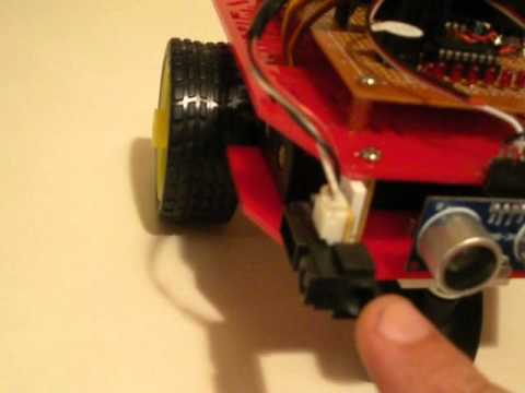

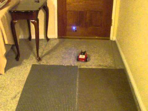

First test using twin TSOP4038 IR receivers to track to a simple LM556 beacon (blue LED on door). Seperately, it uses a Sharp IR distance measuring module as a digital proximity switch. When it gets within 4" of the door it does an about face and drives away for 6 seconds, then repeats the locate & track cycle. Not bad for a first test, I have lots of variables to adjust.

    Very nice! How are the IR receivers positioned? Just a simple V arrangement? Any lenses involved? Do tell.

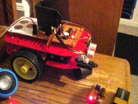

    Three beacon tracking demo. As it turns out, a weak IR signal is better than a strong one to avoid reflections & ghosts. Detection range is 20+ feet from robot to beacon. Ultrasimple beacons are individually coded so robot can distinguish between at least 4 different beacons. Front LEDs show active steering direction towards beacons. Front mounted Sharp IR distance module used here in digital mode as a quickie proximity sensor. Details in ROBOT magazine Nov/Dec plus online bonus material shortly, should be at http://find.botmag.com/111207 I should be able to get a BoeBot working just like this once time permits.

    Thanx boyz. Here's some quickie sensor detail for the construction article. I found the rotary sensor mount quite handy for experimentation. Beacon schematic attached for your consideration.

    Now it's a Speakin' Beacon Seekin' robot. :)
    edited 2012-10-03 05:48
    That's neat speech synthesis always makes more of an impression that displaying the words red, yellow, blue on an LCD. I also like the way you mounted the IR distance sensor on a pivot to switch between wall following or collision mode. I'll have to copy that in the future.
