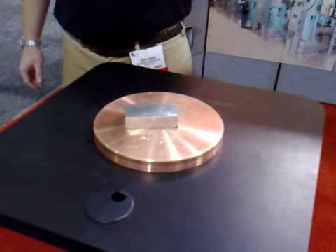

    Also consider if you take a sheet of aluminium and run a strong magnet over it, you will induce magnetic fields in the aluminium and cause the sheet to move with the magnet, though somewhat out of phase.
    edited 2012-09-13 09:40
    @Eddy: Copper pipe tain't ferrous neither! :)
    edited 2012-09-13 10:53
    ...I bet if the temperature of the copper pipe and magnets were monitored throughout the passes, there'd be an increase. Them eddy currents gotta be disappated in some fashion.
    Oh - forgot one thing
    THAT WAS TOO COOL!!!!!!
    edited 2012-09-13 13:13
    Damn, I was trying to demo that effect by having a magnet slide down an ally sheet. Sort of worked. Never though to use a tube.
    Any way if you crack open an old fashioned "mechanical" speedometer you will see that that is how it works. A spinning magent turns an ally disk against spring. Faster the car, faster the magnet spins and the more the disk is turned.
