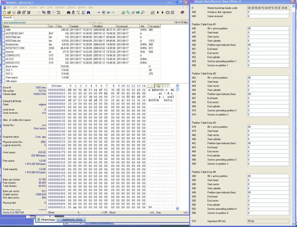

    edited 2012-08-18 00:47
    evanh wrote: »
    That's safe. I'm thinking there's nothing wrong with putting the special string at start of MBR either. If anything else modifies the MBR it'll either leave the first 446 bytes untouched or it'll replace the lot.
    Because one of the wiki shows a use of the MBR sector #0 as a VBR with various descriptors used and the boot portion being at a variable offset. Therefore I chose to ensure it was within the bootable section of the MBR. Here is that wiki page http://en.wikipedia.org/wiki/File_Allocation_Table
    edited 2012-08-18 00:50
    Here's an interesting case.
    Say that somebody doesn't want files written to that SD card. They want RAW data. If a partition is in use, no brainer. They can do what they will with the rest of the card. When it's mounted in a PC, it shows as just blank media.
    That's every bit as valid as "just drag and drop file here" is.
    A partition does both equally well. Poking around in the MBR doesn't.
  • AribaAriba Posts: 2,697
    edited 2012-08-18 00:54
    Cluso99 wrote: »
    Why such a commotion with what filesystem/structure needs to be on the SD card??? Use the MBR record as a pointer(s). This IS WORKING NOW !!! I posted code and so has ariba. We both only have to trim the code to simplified pasm. Our concepts are very similar.
    Clusso, my code is already trimmed to 151 longs in PASM 1 code. The difference is I test only one long instead of a 12 char string, and this at location 400.
    This new version combines the shortcut in the MBR (or what else is at sector 0) with the sectorwise searching for a signature at the begin of a boot-file. It does work here with SD cards (<=2GB) , and SDHC cards (>= 4GB).
    For a bootable SD card you copy the bootfile to the fresh formated SD card - that was it.
    Then the bootloader finds no shortcut in the MBR so it searches up to sector 19000 for a sector with the signature. This takes several seconds.
    So if you want it faster use a (Spin)- Utility to write the shortcut, and now it boots in a few ms.
    You can overwrte the boot file everytime with new code if it fits in the already allocated clusters. If you want disable booting you need to overwrite it with a file with wrong signature, just deleting will not help.
    I have changed the place of the MBR shortcut a bit, so I have also attached the new utility.

    edited 2012-08-18 05:02
    Hi Kye.
    You said That Chip will use PARTITION table info for boot.
    That is not alway true on SD.----
    As You can see from attached pictures ---- My SD that is 2BG and bootable with NT not have in Partition entries any values.
    --- Most of BOOT sector have empty space but still You can see on left side of picture that it have all needed files to boot NT
    So it is most safe to calculate them LOOK on
    > "Boot Sector FAT.jpg"
    It is values that needs to find it.
    1024 x 743 - 174K
    1024 x 781 - 180K
