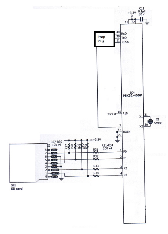

I am new to propeller and have been trying to make a barebones SD card reader. However, I am having issues mounting the SD card using FSRW 2.6. Attached is the circuit diagram and the file I have been using to test. Power and ground are drawn from a BoeBot board.
I have repetitively checked the connections for shorts and incorrect wiring, and have remade boards. I have tried using different propeller chips, prop plugs, and connecting the SD card to different pins. I am using a SanDisk 2GB Class 2 SD card, formatted Fat 16 (tried both quick and full formatting). On a Windows 7 x64 OS, I have tried using different USB cables and updating the VCP drivers. I have also tried running on Windows XP x32.
Every time I run the program I fail to mount.
Any insight would be greatly appreciated.

  • LeonLeon Posts: 7,620
    edited 2012-07-21 19:55
    Here is the schematic of a little PCB I made for using an SD card with a Proto Board:
    http://www.leonheller.com/Propeller/miniSD%20BO/miniSD%20BO%20sch.pdf
    Here is the PCB layout:
    http://www.leonheller.com/Propeller/miniSD%20BO/miniSD%20BO%20Layout.GIF
    I used a Yamaichi NMS011-2000-1 card connector from RS Components (493-2052).
    It works OK with the FSRW 2.6 software.
  • EquinoctumEquinoctum Posts: 4
    edited 2012-07-21 23:03
    Thanks for the quick reply, Leon. Unfortunately, I am still failing to mount with the schematic you provided. I also tried running the code on different xtal and pll. Some show 'fail to mount' while others display nothing or faulty text on the serial terminal.

  • pik33pik33 Posts: 2,417
    edited 2012-07-22 00:33
    Check yor connections (bad solder etc), then check your pin assignment. Try to use Kye's driver http://obex.parallax.com/objects/619/ instead of fsrw. Maybe a 100 µF capacitor soldered directly to SD socket will help (as it helped for me when I had problems with reliable SD card mounting - I have my SD connected directly to Propeller without any resistors, only this 100 µF capacitor between Vdd and Vss)
    edited 2012-07-22 01:01
    Have you tried a different card connector?
    edited 2012-07-22 03:03
    Pin assignment is correct and all the connections appear to be good. Kye's driver gives the error light. The SD card still does not mount after adding a 100uF capacitor between Vss and Vdd.
    I have also tried making different card connectors, and using various combinations of with/without 10k pull-up resistors.
    edited 2012-07-22 03:36
    The only think left seems to be your software. I used test.spin:
    Hi Equinoctum, have you ever tried out, to leave off the 4x 10k resistors (R31 - R34) but use 2 more pullup resitors (one for SD8 (Datal line 1) and one SD9 (Data line 2)?
    I built my own SD-Card Adapter in 2008 in this way and it works on the first try without any probs :)

    If you have only tried just that 1 card you can't rule out the possibility that particular card just won't work with the program. See this thread and post #3:
    http://forums.parallax.com/showthread.php?139976-Update-for-un-usable-SD-Cards&p=1096887#post1096887
    You may need to try a different card.

    I finally figured out my problem -- a jumpy voltage supply and loose connection to the SD card. I switched the card's voltage supply to two AAA batteries (instead of voltage dividing the Vdd of the BoeBot's Board of Education Development Board) and after applying some pressure to the SD card connection pins, everything ran smoothly, passing all the tests. I'm running it fine now without any pull-up resistors or capacitors between Vss and Vdd.
    Thank you so much everyone for all your help!! I can finally rest in peace tonight :smile:
