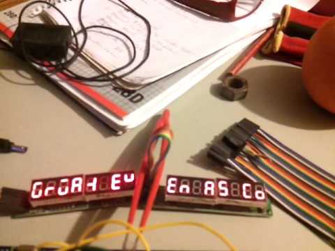

    now that the MAX7219 - 8-digit 7-segment LED driver converges to perfection, there are also those 8*8 LED matrix modules based on this driver chip :-)
    so @Peter if you order displays ... ;-)
    I already have some basic code ....
    and I do not need to run the full Parallax font on them with scrolling etc ...
    I want to just display the temperature profile of my solar storage tank.
    but maybe I can do it more generic ... :-)

    MAX7219 based 8*8 Matrix works even in combination with 7-Segment display.
    E.g. here the temperatures over the height of my solar storage tank.
    800 x 480 - 174K
  • MJB wrote: »
    Looks good Markus, how's the scroll speed do you think for continuous output? I am going to order some displays just for the fun of it, maybe eight in a continuous string.
    btw, the video doesn't seem to work and I find that I have to youtube it and simply paste the youtube id using the youtube button.

    scroll speed at 50ms is too fast - I set it to 100ms after I took the video.
    I put it to Youtube and inserted it with the Youtube button, with Chrome it works for me.
