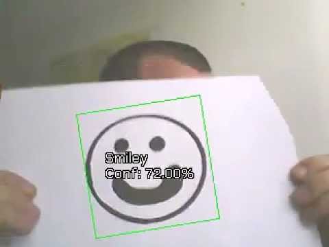

RoboRealm is pretty sweet but it depends on what you use it for. It's insanely easy to use and has a ton of built in programs.
Here's a quick kinda cheesy video, but I used it to pull video from an IP cam, then communicate via XBee back to the robot to move the camera while tracking a color blob.
Since I got it I've had robots follow sidewalks, recognize my face, and write a bunch of external programs that interface with it.
[video=youtube_share;O0-YKMfFXsI]
Here's an example of my VBScript:
Note the variable 'cog_x' and 'cog_y' they're the 'center of gravity' of the blob. The serial code is for the XBee.
Set MSComm1=CreateObject("MSCOMMLib.MSComm") MSComm1.Settings = "9600,n,8,1" MSComm1.CommPort = 7 MSComm1.InBufferCount = 0 MSComm1.PortOpen = True If Err Then MsgBox "COM" & MSComm1.CommPort & ": !" End If cogx = GetVariable("cog_x") if cogx < 120 and cogx => 26 then MSComm1.Output="4" end if if cogx < 26 then MSComm1.Output="5" end if if cogx > 200 and cogx =< 300 then MSComm1.Output="6" end if if cogx > 300 then MSComm1.Output="5" end if if cogx < 200 and cogx > 120 then MSComm1.Output="5" end if cogy = GetVariable("cog_y") if cogy < 15 then MSComm1.Output="c" end if if cogy > 180 then MSComm1.Output="c" end if if cogy < 80 and cogy => 15 then MSComm1.Output="k" MSComm1.Output="c" end if if cogy > 120 and cogy =< 180 then MSComm1.Output="i" MSComm1.Output="c" end if if cogy =< 120 and cogy => 80 then MSComm1.Output="c" end if
