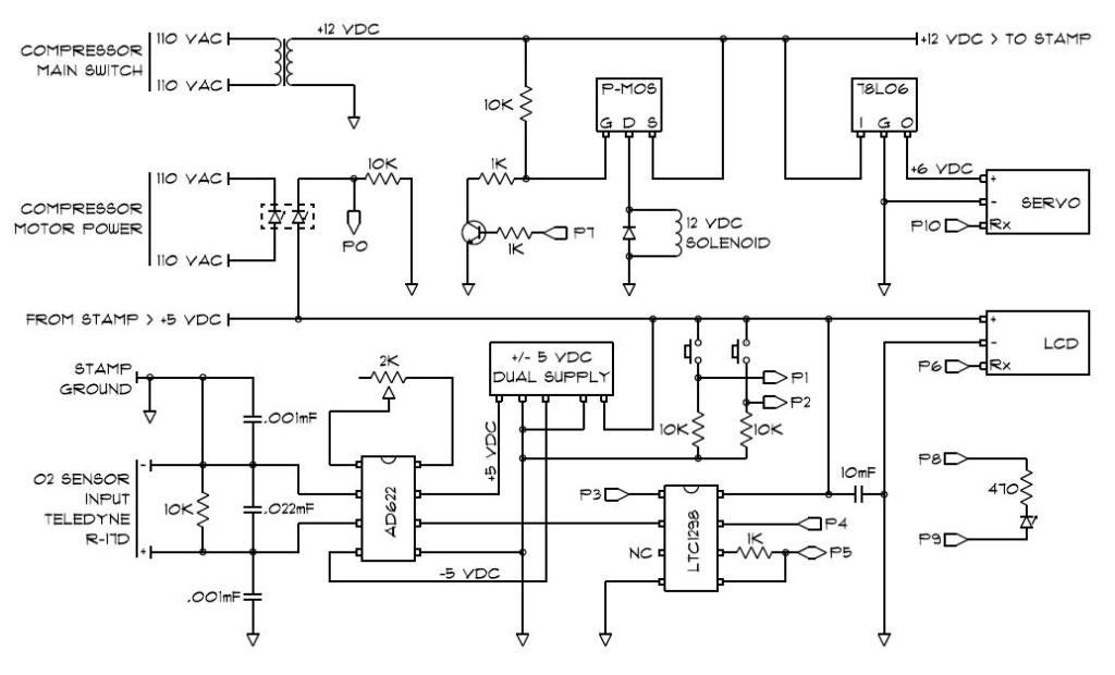

I finally have it working! Thanks so much for all the help from this forum. It has been quite a learning experience and I'm sure I would not have gotten to this point without the help I received here.

    One step back here :( The controller has been working and I'm slowly perfecting the program but another question arose. The solenoid I'm using produces quite a bit of heat which isn't uncommon for these but I would like to minimize this. It is normally closed to shut of oxygen in the event of a power loss so it is contiguously energized during normal operation. It seems that I can lower the duty cycle by using pwm to provide only the necessary voltage to keep the valve open. Any suggestions on how to implement this in pbasic?
  • SapphireSapphire Posts: 497
    edited 2012-06-18 20:55
    PWM won't work for you because it only generates pulses while the instruction is being executed. Since your program has to go off and do other things, you would end up with some pulses followed by a constant on or off output. If you know for sure that your solenoid operates at less than 12V, then you could either change your 12V transformer to say 9V, or put a string of one or more power diodes in series with the PMOS switch. Each diode will drop the voltage by just over half a volt. Make sure the forward current rating on the diode exceeds that of the solenoid.
  • willembadwillembad Posts: 47
    edited 2012-06-19 05:32
    Thanks. That was what I was suspecting. I'll look into supplying lower voltage to the coil. I did get hold of the manufacturer and he said that normal operating temps could be as high as 170F but I'd like it to be less, so I'll tinker some more.
    edited 2012-06-25 14:58
    Replaced the solenoid coil with a 24vdc rated one and it operates just fine with 150mA draw. MUCH cooler than the other coil. Controller is now fully integrated and full tanks of nitrox is coming off the compressor :)
