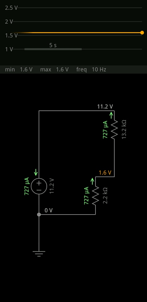

  • RinksCustomsRinksCustoms Posts: 531
    edited 2012-05-28 23:13
    Using values similar to the ones shown in the picture(12.9k & 2.2k), a voltage divider should work for a low voltage trigger of your batteries. If you use a potentiometer, you can fine tune the trigger point. It's a simple and easy to implement solution for your robot to decide when to return home. You only need to have the prop monitor one pin per voltage source,( the prop looking to see if that pin went low yet). When the 12V battery drops low enough, the voltage at the mid point of the voltage divider will drop below the minimum High threshold voltage of the propeller (1.65V). You can use a voltage divider with different values on the 6V pack on your propeller to monitor it's voltage.
    R1/R2 ratio = 5.05 (R1 being the one attached to 12V)
    If you feel that is not enough, i just came across this chip in another post http://www.digikey.com/scripts/dksearch/dksus.dll?vendor=0&keywords=SENSOR+CURRENT+200A+5V+BI+5-CB+
    468 x 960 - 51K
