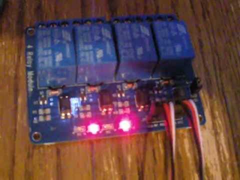

    Just got my 4-relay board today. Works great, best $6.79 I've spent lately!
    ' {$STAMP BS2e}
    ' {$PBASIC 2.5}
    PAUSE 255
    DIRL=15
    a:FOR B0=0 TO 15
    OUTL=B0
    PAUSE 100
    NEXT
    PAUSE 250
    FOR B0=15 TO 0
    OUTL=B0
    PAUSE 50
    NEXT
    PAUSE 250
    GOTO a

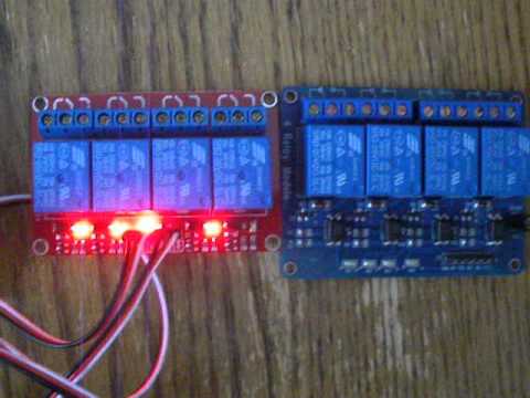

    Received my $5.39 board today. Fast ship! The PCB is red, it's a bit smaller and has different input pins than the previous blue PCB, but functions the same. It has one more LED, simply a power on indicator.
