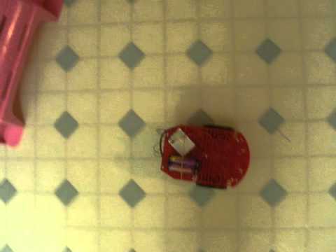

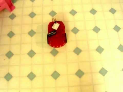

    New gearmotor is noticeably slower in RPM, with corresponding increase in torque. One stock gearmotor 1:48 motor and one 1:87 gearmotor with different motor winding shown here, both operating off 4.8V.
    edited 2012-04-27 19:46
    Think of it this way: your bot is doing one half of a figure-8 course. You're almost there already!
    -- Gordon
