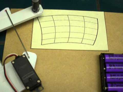

A strange little robotic project I hope to have finished for expo. 3-servo arm writes characters on a Post-It note. Goal is to let kids & grupps type in their name & print it out. Gotta keep up with the S2 printer boys, but low-tech. Just started programming tonight, drawing simple grids & boxes here. Double polar coordinate joints give a funky skewed look to printed material. I like it.

    Another neat project. The double polar gives it a Dali-esque aesthetic.
    Not to beat a dead horse, but inverse kinematics could convert from rectangular to double polar no problem. With only two joints that might be within the computational power of a BS2. Since the device is constrained to a narrow range of angles you'll avoid negative numbers which make trig on the BS2 much harder.

    I'll leave IK to the Prop or coprocessor wizards. It remains to be seen how jaggy diagonal lines will be, moving both servos simultaneously. That may take some tweaking. I suspect this printer's strong suit will be the smooth "straight" arcs moving just one servo at a time, shown here. Besides, I need the simplest font and print routine. It's likely that the BS2's 2K memory will be chock full just holding data to draw 26 letters. Dare I dream of including numbers, too? :)
    Sample font shown.

    Progressing nicely, just a few letters left to code. Heckuva lot more work programming a simple vector font than I expected. The BS2 memory will be crammed full with all the data. I just love maxing out memory space.

    All 26 letters in, EEPROM 100% full. Hoping to crunch a bit more so I can write EXPO 2012. ZOIZ just ain't doing it for me! :)

    Finished! Step right up at Expo and print your own badge on erco's "poor man's printer". I made a PS/2 keyboard serial adapter so my laptop won't be required to use the printer. The keyboard plugs right in. This one's finished, so now on to work on my robot catapult ...

    Thanks Tommy. Just two words on print speed: painfully slow! Initially I had high/low speed control to help move things along faster. Moving one servo at a time can go quickly for straight (arced) lines, but coordinating two servos for diagonal motion (letter X, N, S, etc) required slower movement. In order to fit all the code in a vanilla BS2, I had to ditch the speed control commands and run everything on default SLOW. Letters take ~4 seconds each. Plenty of time to socialize while people print their badges! :)
    I hope to code a one-press macro to print "Parallax Expo 2012".
    Code attached here so I can access it at Expo when I forget to bring it on the netbook.

    Thanks Martin_H & Publison. I chopped it down to 99% by replacing a lengthy DEBUGIN with SERIN and combining a few letters together. Had to get creative: CDGOQ is a single routine that can make any one of those letters, starting out by drawing a C, then branching as necessary. Adapt & overcome!
    It's more typewriter than printer, as it prints "live", one character per keystroke, spaces and return included. No editing, no formatting, no LCD display. Makes you plan ahead and type carefully! Also, there wasn't any leftover room for a macro, so I loaded that into the serial keyboard adapter. Press 9 and it automatically parses "PARALLAX EXPO 2012" to the printer.
