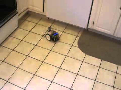

Matt put out the call for some code samples to show off Parallax gear at the Expo. I'm planning on two wall following examples. The first uses a single Ping))) sensor with a BS2e controlling the CBA. It should run nearly unmodified on a Boe-bot once you change the stamp directive.
This sample follows a wall using arcs towards the wall and then a turn away from the wall. Like most of my good ideas it came from Robot Builders Bonanza

' This program can be used with a CBA or Boe-bot to follow a wall using only a
' single ultrasonic sensor. The basic concept used is from page 609 of "Robot
' Builder's Bonanza" by Gordon McComb

IF (X > WallDistance) THEN
' Pulse once
PULSOUT RMotor, Speed050R
PULSOUT LMotor, Speed075L
PAUSE 15
ELSE
' Pulse turn count times to strongly turn away from the wall.
FOR X = 1 TO TurnCount
PULSOUT LMotor, Speed050R
PAUSE 15
NEXT
ENDIF

Here's the code which is nearly identical to the previous sample except for a slightly altered main loop.

I published the videos and code to the forum in the hopes that someone who goes might use them and have some fun with them. They should run on a Boe-bot with just a Ping))) as no servo is used, one of the whiskers would work as the bumper.
