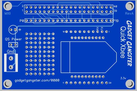

Started working on an QS Xbee board this morning.. Any feature you Xbee users would like to have?
(RevA, still sanding the edges.... ;) )

    Full size SD socket.
    edited 2012-03-20 10:21
    Ouch! Settle for connections for a microSD module? ;)
    OBC
    edited 2012-03-20 10:25
    That would probably be acceptable.
    Are ya’ll going to see these as blank boards, kits or both?
    edited 2012-03-20 10:27
    Kits and blank boards upon demand..
    OBC
    edited 2012-03-20 14:20
    I would think the default for add on boards for Quickstarts should be that they don't cover the touch pads.
    I would vote that the only time you should cover them is if you are reusing the pins they are attached to...

    @Roy
    I'm not even sure it would still fit if we did that.. (ponders) Quickplayer is the only board slated to leave the touchbuttons open at this time. The servo/sensor board reuses them at the same positions.

    I saw an Xbee board (Arduino shield) that supported 2 sockets... Curious, I thought until I saw the XBee footprint GPS module.
    edited 2012-03-20 16:53
    Ok, I think I'm getting closer...
    Added servo/sensor style servo head.
    Added connection point for microSD module

    Looks pretty nice. My only input is lame, but since it came to mind right away when I looked at the board, here it is... How about "quiXbee" instead of Quick Xbee?
    edited 2012-03-20 20:17
    OBC,
    Couldn't the Xbee pins straddle the 40 pin connector? Or just reverse the 40 pin connector and have this board hang off the other way.
