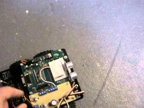

In my basement I set up a six foot long obstacle course ending in a barrier. The goal is to have the robot make it through the uneven surface and stop when it reaches the end. I tried it with two wheel drive, tracks, and four wheel drive.
[video=youtube_share;4BfwvPFvyPw]
Only the 4x4 made it through unassisted, but TankBot would have done fine if spent the time getting it to drive straight. The bottom line is the 4x4 has some real promise for travel over uneven ground.

    I finally got a chance to try my own challenge of peril. In this video CBA travels 6' along a 6" wide board without falling off. It turns out it is almost exactly like line following and I even used the CBA line following module to do it.
    [video=youtube_share;QSHjBhUUWVU]
    edited 2012-03-25 15:10
    Very nice. Not unlike Rooba's "cliff sensors", designed to stop it from falling down stairs. I wonder what it's reliability rate is. :)
    edited 2012-03-27 06:42
    Thanks. There's a reason the board is on soup cans instead of a pit of flames. I found that if you tried to parallel the edge eventually when the robot turns away the wheel would slip off the edge. Those wheels don't have much lateral traction so the rest of the robot would follow. I then tried the curving back towards the edge to ensure a steep angle of attack and give the wheel room to turn without slipping off the edge. Probably an even wider sensor separation would solve that too.
