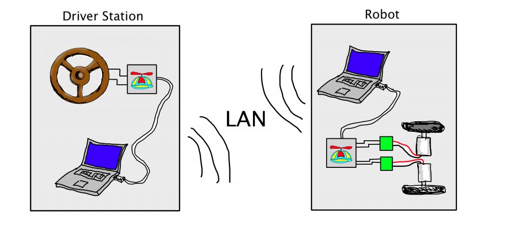

I need a windows (multi platform would be nice though) program that can be run on both the driver station laptop and the laptop that is on the Eddie Robot, that will transport serial data coming from the driver station Propeller Chip to the Propeller chip on the Eddie Robot. We are not using MRDS.
A simple diagram follows;
It seems so simple but this is out of my area of experience.
Compensation can be either via PayPal or in the form of a rare unopened black Penguin Robot. The code will also be shared for others to use - it seems like it ought to be useful.
I have had a couple people already tell me that they could do it but follow up has been non existent, so any takers, please be dependable.
Also, this *may* lead to more work in the future .

    Is it *required* to have two PCs in the picture?
    It seems that the user station would want display capabilities to show user interface elements to the user. Does this *need* to be a PC?
    I would think that the remote end on the robot would not need the extra weight etc. Does the remote *need* to be a PC?
    I'm all about sorting out requirements BEFORE coding starts. This might be something to look at. Right now you eliminate anybody that wants to help that does not have both a pc AND a laptop to spare.
    IF you divide it up into easier, less specific parts, the more flexible parameters might attract more interest.
    Yes.
    The program that I need written is only to move serial data from one Propeller to the other over a local area network.

    And yes, you have lots of layers of network to think about. It is a big project.
    LAN only. My understanding is that it is NOT a big project.

    If you are trying to go from prop to prop over the LAN, why not just use a Spinneret on both ends? The one on the eddie would need to be plugged into a wireless adapter...
  • W9GFOW9GFO Posts: 4,010
    edited 2012-03-15 11:20
    Having a PC on both ends is the requirement.

    Can the two PCs have a server/client relationship? IOW, one PC (the server) listens for commands and responds, while the other PC (the client) is responsible for initiating communication.
    edited 2012-03-15 12:10
    One more question: Do the laptops have to be configured for ad hoc (peer-to-peer) wireless networking, or can they communicate through a wireless router?

    Rich,
    I think that would be fine.
    edited 2012-03-15 19:50
    I think that through a wireless router is preferred.

    Rich,
    Try the attached. It's very alpha, but it might work for you. There are two programs in the zip: a server and a client. Both should be started from a DOS command line, the server first, then the client. The default IP port for the server is 12345, but you can change that to something else if you like. Just be sure that, whatever port you choose, any firewalls in the path have a hole in them for it.
    You can get instructions for each program by running it with a "help" parameter, e.g.:
    serial_server help
    Once both programs are running, anything received from one comm port gets set to the other, and vice-versa. I tried hitting it really hard with data and had some issues with the Propeller getting hung up. I'm still trying to figure out what's going on with that.
    If it works out for you, great! Consider it repayment for the MakerBot extruder you built for me, which works like a champ! :)
