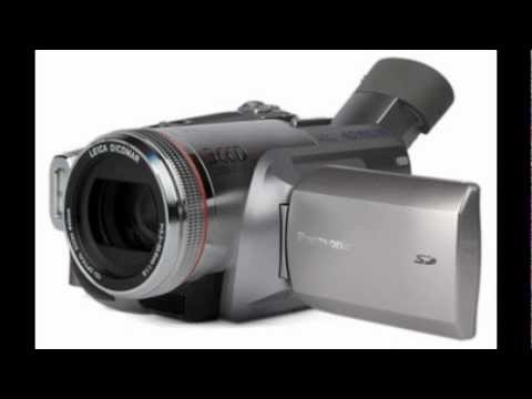

Purpose: To send the remote control record function of my camcorder according to sound level in the room.
[video=youtube_share;6Uaeq7NyR3M]
  • RagtopRagtop Posts: 406
    edited 2012-02-27 13:08
    This was giving me a bit of a problem to code even though it seemed rather simple. I eventually broke down and flow charted it to help me out.
    When sound is detected it will signal the video camera to record for 20 seconds before checking for sound again. If sound is detected then it will
    wait another 20 seconds before checking again. If sound is not detected it signals the camera to stop recording.

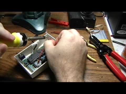

    It is working, but will be another month and a half before I really get to try it out.
    [video=youtube_share;YHOj21B4gjY]

    I didn't get too many of these game mission captures as my camera sound activation device
    keep getting into reversals (turning camera off instead of on). Got some
    more fine tuning to do, but still pretty happy with it as it gives me a way
    of getting this information for my videos without having to have the Wayne's
    World crew change what they are doing.
    [video=youtube_share;HwRY8aO6aEA]
