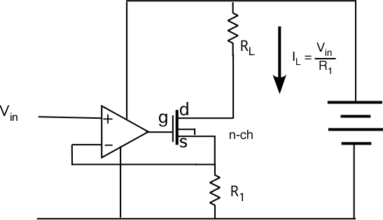

    What frequency is it oscillating at? A few Hz, or several MHz? You may need to increase the capacitor significantly more to make a difference if it's oscillating slowly. If it's fast, then put a resistor (1k or so) between the op-amp and the MOSFET.
  • BitsBits Posts: 414
    edited 2012-10-24 09:32
    Its a few HZ and I have tried larger Capacitors 100uF as an example. I really think that the feedback resistor is the issue as too small of a value creates an unwanted oscillation. Then again I could be wrong.
  • CircuitsoftCircuitsoft Posts: 1,166
    edited 2012-10-24 09:58
    That could be it. The MOSFET probably has a pretty high gain near it's cutoff voltage, so when the resistor gets that low, it acts a lot more like a switch. A larger current-sense resistor actually lowers the effective gain of the MOSFET reducing the frequency response of the system as a whole and bringing any poles closer to the 0 provided by the cap in the negative feedback of the op-amp.
  • Tracy AllenTracy Allen Posts: 6,664
    edited 2012-10-24 10:02
    "I did change the capacitor on the gate but this approach did not affect the oscillations. "
    Could you draw out the circuit values as you have them? Here is the circuit from post #51. When you have 0.01Ω for the shunt, what values do you have for the other components?
    I think I would try connecting the right-hand side of the capacitor to the source of the mosfet instead of to the gate. (That is, the node where the source meets the 10kΩ, 30mΩ resistor.) Again, experiment with the C value.
    "I really think that the feedback resistor is the issue as too small of a value creates an unwanted oscillation."
    A resistor is a passive element and won't create an oscillation by itself. The oscillation comes from delays, phase shifts, in the whole feedback loop.

    "The MOSFET probably has a pretty high gain near it's cutoff voltage"
    Circuitsoft, but the mosfet in this circuit is a source follower, so the gain in any case is just a hair's breadth below unity. What do you think about connecting the capacitor to the source instead of the gate? There shouldn't be much of a phase difference, unless...
    I'm wondering if Bits put a resistor in between the op-amp output and the gate. I'd go with more like 100Ω there, otherwise it will cause a big phase delay with the input capacitance of the large mosfet, and a compensating phase lead directly from the op-amp output would certainly be necessary.
    For newbie to analog type circuits (like me), I will try explain what it is doing.
    The 4.7k and 300 ohm on the left creates a voltage divider (300/4700*5v =0.31915volt)
    The two 10k in series resistors, limits the currents and smooth's out any spikes.
    The 30mO (0.03 Ohm) before gnd allows you to measure voltage drop vs current and the amp will compare it to 0.31915volt.
    The output from the amp will be in the mosfets half open/half closed state region (does create heat)
    the more current flowing the more is try choke itself, but that could induce oscillation and capacitor placed at right place will help.
    edited 2012-10-24 10:50
    Almost.
    300/(4700+300)*5v = 0.3v
    The 10k resistors are there to equalize voltage differences that could arise from any input current of the op-amp.
    edited 2012-10-24 12:45
    From my testing the voltage divider is not even needed in the circuit and it all boils down to this simple equation.
    Current through heater element = Voltage at + op-amp / power resistor or...
    I = (+v) / (.05 Ohms) as I am using a .05 Ohm resistor at the moment.
    That simple! I swapped out all the resistors with assorted values and conclude that the equation stays the same no matter the resistor sizes.

    That's the fundamental principle of negative feedback with an op-amp. The op-amp if possible will make the voltage at the two inputs (+) and (-) equal to one another. All the other parts in the circuit are there to make a given output from a given input possible and stable within the allowable range of the op-amp inputs.

    Bits wrote: »
    I still cant visualize why I place 0 volts on the + and the output is 2-4 volts depending on mosfet selected.
    Do you mean 2-4 V on the Opamp output pin ?
    That is 100% expected, as the Opmap output moves to make the + and - pins equal.
    That 2-4V on the Opamp output is the linear operating range. The Source voltage is what it cares about.
    If you happen to hit an opamp with a high offset voltage, such that the -ve pin cannot go negative enough, then the Opamp output could go to ~ 0V, and the circuit would be outside the linear region. As the +ve ip increases, you would see a change to linear operation, and 2-4V on the Op/Gate again.
    It's because the feedback is coming from the MOSFET's source pin, not the output from the op amp. The voltage on the output pin will be whatever the MOSFET's gate threshold voltage is, IOW the voltage that it takes to just begin making the MOSFET conduct and provide a non-zero feedback voltage to the op amp's negative input.
    edited 2012-10-24 16:02
    Here is the thing I can even cut the trace above the mosfet and it still reads over 0 volts on the op-amp output. How is this possible if both pins are 0 then the output should be 0 right?
    Attachment not found.
    Phil is it that simple? I am looking too deep into this I think.
