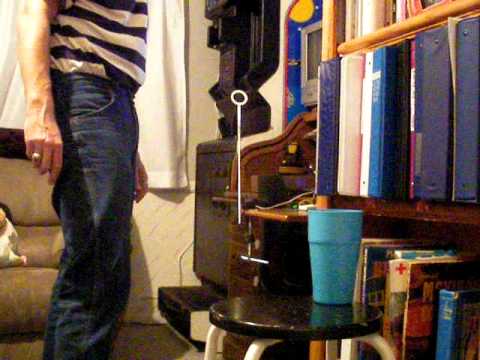

I was so impressed by the "Positive Pressure Gripper" thread & video at http://forums.parallax.com/showthread.php?137966-Robotic-arm-uses-quot-positive-pressure-quot-to-work-its-magic&p=1074926#post1074926 that I wanted to see if my simple robot arm could shoot any baskets. But after rethinking the G-forces and resulting abuse involved, I left my 6-servo arm alone and made a single-servo catapult-style shooting arm test jig to see how repeatable a servo "sling" could be. Pretty dang repeatable. Futaba S3004 analog servo running on a 7.4V lithium battery and my fave, a BS2 HW board. The arm is 14" long, lightweight aluminum tube.

    7,4 volts for a Futaba S3004 is it not a bit high ?

    Great feedback, lads. I envision a second servo as a turntable to steer the arm to hit a variety of targets at diffferent distances, requiring different trajectories. This simple design puts a lot of stress on the servo. The "launch" sequence is simply slamming from one pulsout position to the next. The servo speed is limited, that's why I ended up with 14" arm and operating at 7.4 volts. It would be more efficient to use the servo to cock a rubber band or spring catapult and release it, but that would complicate things a lot and probably require 3 servos (cock, release, and change endpoints) to do what this one is doing now.
    The consistency is surprisingly good, but the servo power will probably degrade over time as the motor brushes & commutator wear. Such is life in the big city, but it's fun for now. Too bad the scale is so big. I'd like to nail everything down to a board. Like a 4x8 board!

    According to ServoCity specs, a cheap Hitec turns faster (HS-311=.15 sec/60 degrees) than my cheap Futaba (S3003/3004=.19 sec/60 degrees). That's pretty significant in this application. Looks like I'm off to Pacific Coast Hobbies again for another HS-311 or two.
    @PJ: As I said, I had to use a long arm and 7.4 volts to the servo to achieve that moderate toss. I'm not above trying 8 or 9 volts either. Tune for minimum magic smoke...

    Perhaps you may want to look into a rotary solenoid to replace the servo. They can provide tremendous torque through a range of arcs (determined mechanically) and probably could hurl a missile quite some distance. Activation couldn't be simpler, a high current mosfet and a healthy 20-24 volt power source. By shortening the power pulse shorter distances could be realized. Since they are basically a very simple mechanical device with a coil they can take a lot of abuse.
    edited 2013-05-08 17:39
    Hal Albach wrote: »
    For the ultimate in simplicity, how about nothing, which the current servo requires? :)
    Additionally, the servo's trajectory (range of arcs) is all programmable using pulsouts.
    It works amazingly well over a variety of trajectories. The only change I'd consider making would be to increase the range by using a torsion spring. The servo would preload the torsion spring to a programmable amount, and then the lightweight catapult arm would be unlatched by a tiny release solenoid.
