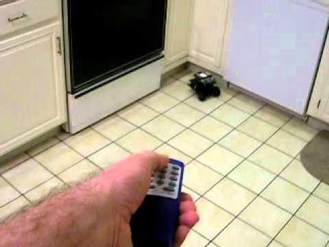

    Here's a video of it traveling around my kitchen:
    The firmware was tuned for the sumobot chassis and tracks. The roverbot is more responsive and it over-steers using some of the built in programs. For user defined programs it should be fine as you can compensate. No plans for this bot at the moment, but it has plenty of room to add stuff to it. I put this in a separate post due to flash airspace issues.

    Martin, RB looks good. Nice demonstration of the agility of the platform. I especially like the white swivel caster. I'm surprised Erco didn't mention something about it! (Though, truth be told, the little 1-1/4" casters from Lowe's have exceptional spin ability -- much better than their $1.75 or so price suggests.)

    I am slicing my time between three projects right now and plan to do more with this bot in the near future. I found the original documents for the control board and it has overload protection in the h bridge, so I am good there. I will post a video here when I have a project with this bot complete.
