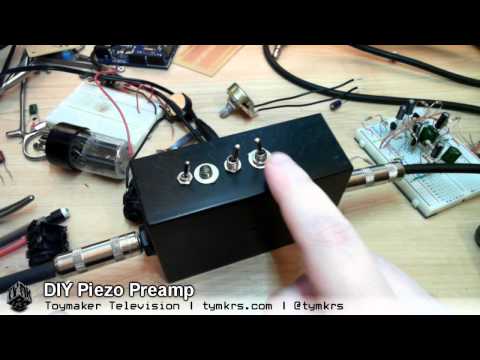

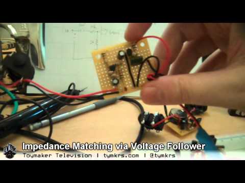

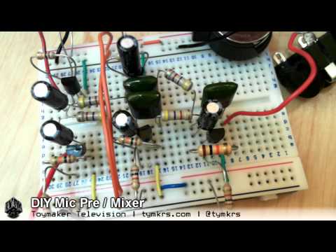

and we happened to use the LM2N3904 and MPF102 JFet transistors. Those gave us the cleanest sounds, but we've done an audio amp with a LM386 before as well: http://www.tymkrs.com/forum/viewtopic.php?id=17
For examples of how they sound:
MPF102 High Impedance:
LM2N3904 High Impedance:
LM2N3904 Low Impedance:
Let us know if you have any questions
