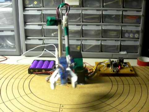

Mini 6-axis arm underway. Here's what I did tonight:

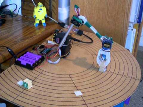

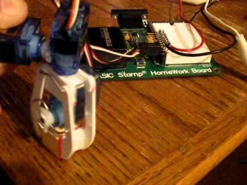

    Are you planning to do inverse kinematic transforms using a co-processor, canned motion scripts, or something else?
  • ercoerco Posts: 20,257
    edited 2012-01-27 08:14
    Grippers are finnicky, they're a whole science to themselves.
    No co-processor for me. That's cheatin'!
    For now, canned scripts, ultimately will use an IR teach pendant. Will try several different processors on this arm. BS2 HW board shown here.

    First test. Looks like it has some potential! Kinda looks like a snake the way it moves. Yeah, I meant to do that...
    edited 2012-02-09 04:43
    Looking good. I like the base you have it on, those lines should really help you with the motion scripts.
    edited 2012-02-09 08:35
    That's $30 worth of servos and $10 worth of superglue & kicker. Poor man's "rapid prototyping" !

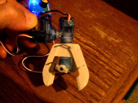

    What kind of wire are you using in your linkage?
    Amanda
    edited 2012-02-09 21:28
    I guess you mean the bellcrank wire linkage in the gripper, as opposed to the electrical wire running through all the joints...
    PAPER CLIPS, of course! Plentiful, strong and easy to bend. Large wire paperclips.

    Ted: Sure, here's a pic for you to hold you over until your next Robot magazine arrives! :) It's a quickie slam build, CA gluing servo to servo and aluminum tube. It's beauty lies in its simplicity & low cost. The whole robot costs ~$50 if you know where the deals are! At that price, it's not currently controlled by a Parallax product, but it will be at some point. :)
    816 x 612 - 59K

    This thing is a hoot! More accurate than I dare hoped, with light loads anyway. Everybody oughtta build one of these, they're lots of fun to play with. Er, I mean, scientifically calibrate and empirically determine the coefficients of dynamic performance. :)
