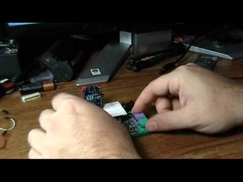

  • RagtopRagtop Posts: 406
    edited 2012-02-12 13:42
    BUTTONS.
    [video=youtube_share;RCqQITcBg9U]
