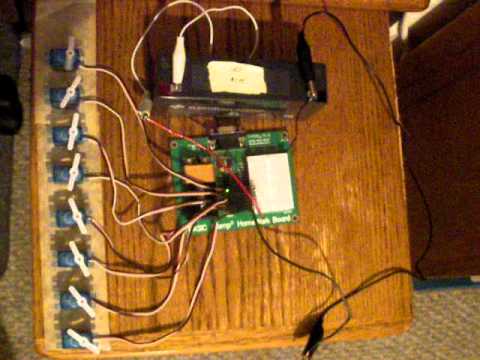

Theoretically, you could control 4 or 5 servos with a Basic Stamp (whether using a Board of Education or some other board). Practically speaking, that's all the Stamp could do ... no sensors, no decision making, etc. There just isn't enough time left over to reliably do anything else. The 5 servo control pulses could take 5 x 2 ms to produce (= 10ms out of a control cycle of 20ms). The remaining 10ms would quickly be absorbed by a few other statements at a rate of 150us to 1ms or more per statement. You could add a pair of ServoPALs to your Stamp to take over the most time consuming part of the servo control and your Basic Stamp could easily handle 4 or 5 servos.
I hope to find time this weekend to test a BS2's ability to drive multiple servos. High time we answered this question. It's been a while since I destructive-tested the BS2's quadrature encoder reading ability.

You're on, Duane! I'll see how many servos a BS2 can run, you see how many a QS board can do. Something along these lines (using "another" processor) is my goal:
So does each servo need to move at a different rate? I'm not sure I have 31 servos without using continuous rotation servos too (at least not until my recent HobbyKing order arrives).
What should we do? Have each servo oscillate at a different rate with continuous servos changing speeds with different accelerations?
Edit: If the QS doesn't need to communicate with anything, I might be able to have 32 servos moving. Now if I could use some 595 shift registers, then you'll really see something!

My goal in that video was just to have each servo constantly moving out of sync. I have downstream plans to make a snake and I'll need an undulating motion...
Thirty or so servos shouldn't be a problem for a Prop. It'll be a big problem for the battery on your robot. You do NOT want to command all those servos to move at once. The proper way to do is move each one separately. Otherwise the battery just can't handle all the simultaneous current draw.
You actually don't want each servo out of sync (positionally) with one another. Like a sine wave the segments just repeat X times for the given length. At most you could taper off the segments toward the rear, but those segments simply describe a shallower sine wave than the wave before it.

So you know, my snake has 10 segments, is controlled only by an Arduino (position and transit speed), and has sufficient -- but not great -- time left over for other things. Everything is hardware interrupt driven, and of course hardware timer driven for the servo PWM. There are no blocking delays in the code, and that's the key to making this stuff work.
Most of the times I agree with your answer but not this time. It is very misleading. It does not take 10 ms to produce 5 2 ms pulses in just software. It is the time you need to route the timing pulses to lots of servos is one of the factors that limit how many servos you can run at one time. I can very easily run 8 servos on a low cost microcontroller with time left over to do other things.
The formula 5 servos x 2 ms = 10ms just is not true for microcontrollers. Your formula may be true for the BS2; I don't know, I never used one.
"There just isn't enough time left over to reliably do anything else. The 5 servo control pulses could take 5 x 2 ms to produce (= 10ms out of a control cycle of 20ms). The remaining 10ms would quickly be absorbed by a few other statements at a rate of 150us to 1ms or more per statement."
Al, I looked back at Mike's post. I thought he was pretty clear about discribing the issues with a Basic Stamps. I'm sure many other microcontroller can handle more servos but the Basic Stamp has to wait for the pulse to complete before continuing its execution. So the "5 servos x 2 ms = 10ms" is true for a Basic Stamp. There actually some overhead so a 2ms pulse will take longer than 2ms.
I don't see how Mike's post was in the least bit misleading. He was clearly talking about Basic Stamps not microcontrollers in general.
