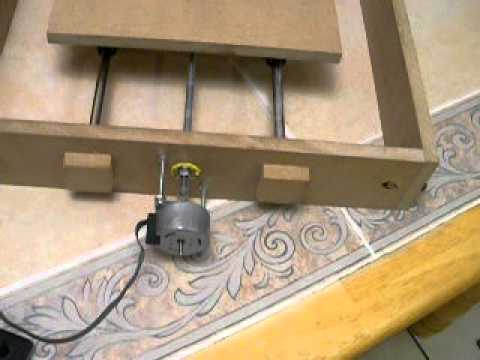

This project started out as an attempt to build a linear actuator out of a spare GM-8 motor, some left over threaded rod, and some parts from an old junked printer. With an assist from Phil Pilgrim I got that working as detailed in this thread:
http://forums.parallax.com/showthread.php?136319-GM8-Motor-Output-Shaft-Coupling-(Video)
But the project took a major change in direction when I began fiddling with the stepper motors that were also in the old printers and a driver chip suggested by Bruce. I also saw some online videos of the Mantis CNC machine and thought "Hey I'm 1/3 of the way there!" and made this video:
[video=youtube_share;F1sF2BvbkNw]

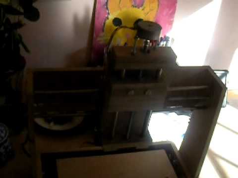

Well one death march later and I am deluding myself into thinking I'm 2/3 of the way there with this video:
Sorry about the video quality, I got bit by the automatic gain control due to sunlight coming in the window. I also have the Z axis completed, so I will test that shortly. My goal after that is building the full control electronics using three stepper drivers and an open source 3 axis g code interpreter written in C. I then want to try to draw a circle using a sharpie, and if I do I will consider the project a smashing success.

    Thanks Duane, if the sharpie test works I plan to try light duty milling (e.g. routing PCB's and cutting foamed PVC) using either a Dremel or the Mantis cheap spindle design.
    My understanding is that 3D printers use belts or the coarse thread lead screw to increase head speed. This draws the plastic filament thin and increases resolution. So a slow machine with torque is good for milling, but bad for printing. Good thing to because the extruder on a 3D printer looks hard to make.

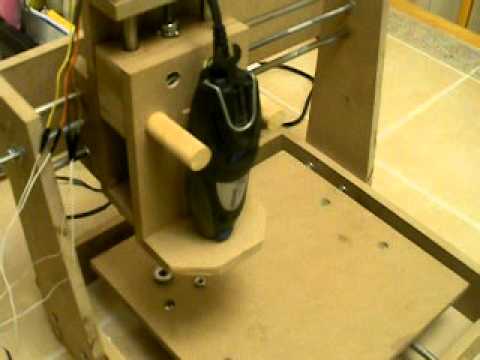

    I got some time tonight to test the Z Axis with the tool holder and Dremel on it. Here's the video:
    That good news is that the salvaged stepper was strong enough to raise and lower the Dremel, so it is looking good for the sharpie test. The bad news is that the video includes a demo fail when a lock washer failed to hold a bearing in place. I also ordered my other stepper drivers, but they haven't arrived which puts this project on hold until they arrive hopefully early next week.
