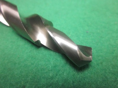

While modifying a drill bit this morning, I remembered this comment:
But, seriously, the flutes of a drill bit are not cutting edges for materials other than human flesh. Try enlarging a hole by applying lateral pressure to a drill that's rotating in the hole it drilled. You can't do it. With an endmill or reamer, though, it's a different story.
I must say that I respectfully disagree. By reducing a portion of the diameter of a drill bit through a grinding process, thus creating a step bit, the second step which is no longer associated with the cutting tip, consisting mainly of fluting, is quite capable of boring a hole.
.. By reducing a portion of the diameter of a drill bit through a grinding process, thus creating a step bit, the second step which is no longer associated with the cutting tip, consisting mainly of fluting, is quite capable of boring a hole....
As I've understood it, the reason the flutes are sharpened is only so they can cut through any chips that might form and get stuck between the hole and the flute. The flute edges, by themselves, make terrible milling bits. But from the sound of it, Bruce, you've just made yourself one of these:
Exactly, that is a step bit, but by machining it myself through a grinding process, the sharp edges of the fluting on the smaller diameter have been removed.

When the drill is ground, the larger diameter portion does then engage like a cutter, just not laterally, and it's cutting surface is significantly diminished from the potential a drill has otherwise. For small steps, this works, but heat can be a problem with the cutting surface at the step.
