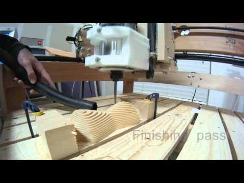

    You can build a CNC machine that will do "wood milling" relatively easily. I made one with a drill press and miter saw from plans I bought online for $50. The machine itself cost about $1200 total, and had a cutting area of about 23" square. I used it to make the machine I have now, which has a 48" x 60" cutting area and it much more rigid and faster.
    These are examples of what you can do with just the wooden machine:
    http://www.facebook.com/media/set/?set=a.79583123972.102562.671403972&type=1&l=ca50239e9d
    And here's the build log and some stuff I've done with the big one:
    http://www.facebook.com/media/set/?set=a.10150268257853973.377792.671403972&type=1&l=9c0575f01a
    The accuracy I got from even the small wooden one was astounding. I had some vague ideas of what I'd do with it before I built it, but believe me - the stuff you realize you can do once you have one will keep you busy for a while.
