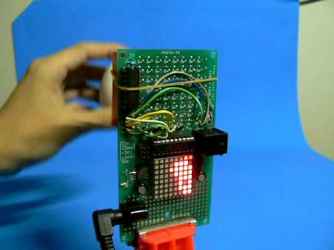

Scribbler's 1 & 2 have a three cell eye and "Robot Builder's Bonanza" discusses building several home brew vision systems. For the past year I've used the Parallax line scan camera for as Scribbler's vision on steroids and Jolt. While I like the line scan camera, it only has one dimensional vision. But this video takes a home brew vision system farther than I've seen. He has a two dimensional vision and added a lens:
That's a pretty small image and 32 x 32 seems more useful, but it seems usable for object detection in two dimensions. Not sure how he would threshold it for different levels of sensitivity unless he had an ADC.

    Very nice. I'm a documented lifetime fan of the KISS principle, and that's a sweet app. I've seen those 8x8 LEDs on Ebay, and this is exactly the sort of use they are perfect for.

    It's not clear from the video whether the camera can provide actionable data to an external processor, or if the photosensors are just connected directly to the LEDs and nothing more. 'Interesting concept, though.

    Yeah, I followed the link to his website, but it's not in English so I couldn't get more details. From the pictures here http://nicotak.com/robot/camera/ it certainly looks like he's hooking up to the NXT brick. The brick uses I2C, so I'm guessing that's how he accesses the matrix outputs.

    All of the NTSC machine vision projects have a common trait in that they collect a lot of data and then throw a lot of it away. What's neat with this phototransistor matrix is that he gathers very little data, but that makes it easier to use.
