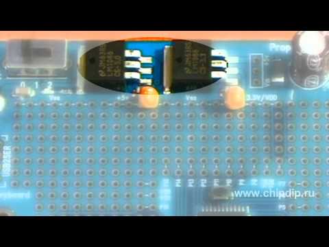

    Welcome to the forums, smiley. Great to have a new friend in Russia. And no need to apologize for the English - you should hear our Russian.
    In case you are interested I found this video in Russian:
