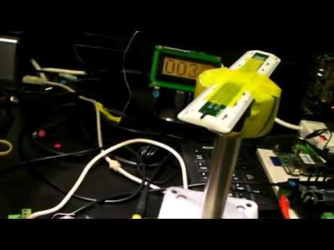

I have only just been getting back to this stepper board and running some tests on a 91mm NEMA34 (34HY1801) motor @24V. It seems with the mass of an drive roller attached I can run this at up to 2400rpm. I have a particular job where I need to ramp from normal process speed up to as high a speed as possible for half a second or so.
Just wondering what kind of speeds are achievable with other steppers and motors? Has anyone done any tests in this regard?
I've got a 60mm diameter roller on the end of it which drives a 300mm long belt and there's another NEMA34 on the other side and normally the motors are running at the exact same speed. The winding is 1.2 ohms and rated at 2.8A but the average measured running current total for each motor is normally around 0.5A.
I have done a lot of tests now and have concluded that with a nominal 24DC supply that I can run this motor reliably up to 2000 RPM and I have pushed it to over 2500 RPM but it's that weak a feather could stop it. There are a lot of registers in the L6470 that aren't explained very well but I think I have enough of a handle on it for now. Here's a short video if you are interested.

Wow! I've pushed my NEMA34 up to 3400 RPM and beyond. The L6470 can be set to switch to full-step mode automatically above a set threshold and so I am running the motor in full-step mode at this speed. Sure is fast for a big motor. I will try a smaller motor next to see how fast I can push it.
For the last 24 hours, I have been reexamining some of my old schematics and reviewing the characteristics of both the L6470 and the L6208. During this time, I have been weighing the value of speed (full/half step) versus accuracy (microstep), and then it dawned on me about this threshold. As you know, the L6208 is intended for half/full step operation, whereas the L6470 is intended for microstepping operation, however I am now contemplating putting D/A converters on VREF_A and VREF_B of the L6208 to achieve somewhat of a programmable resolution (microstepping thru full stepping). I would assume this is similar to what you are referring to on the L6470.
I'm familiar with the L6208 and other variants etc and I don't think that there is anything that they can do that the L6470 can't. Look, if you don't use all the features and just run the L6470 in dumb full/half step mode with an external step clock you are still far better off IMO than using the L6208 in this dumb mode. Once you start using any degree of current control or micro-stepping then you are already in front as it's all built-in, you don't even need external current sense resistors. BTW, the stepping modes can be set from full-step, half-step etc to 128 microsteps. These chips run as cool as cucumbers.
Anyway, I found a bug with this auto full-step switching as it appears it doesn't actually switch to full-step but another microstep mode instead. However I am awaiting some feedback from ST about this.
