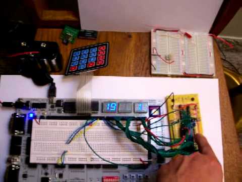

I am working on a project to fully use the PPDB with as little extra components as possible, so far I've had to add two PCA 9555 IC's and have added a 4x4 Matrix keypad that will be connected to one of the PCA9555 IC's. With the exception to the I2C Bus Expanders, I will be using parts available directly through the Parallax Store.
I will be updating this post as the project progresses. I anticipate the total cost of the project will be around $300 US for all the parts and the PPDB. I should also note that I will be adding a GPS Unit later, after I have a 4x4 Matrix Keypad working.
Parts Needed So Far:
Please see my Blog for more info http://forums.parallax.com/blog.php?53890-Jorge-P . In the mean time, here is a video. NOTE: This link will update as the project progresses.

V1.4
  • Added the 4x4 Matrix Keypad on Propeller pins 8 through 15
  • Pressing the * and # keys together on the keypad displays the date.
V1.3
  • Changes to the code and pin outs.
  • I can now display the date by pressing the PPDB's Button 0, and the date will display until you release the button.
  • The previous version was 1.2 so this update is 1.3. (Code will be available by 5pm)

    Nicely done!
    I missed what the second board wired to the PPDB was ( the little one toward bottom right).
    Hope you get your flicker under control!!
  • Jorge PJorge P Posts: 385
    edited 2011-09-16 08:22
    mindrobots wrote: »
    Nicely done!
    The board in the lower right is one I made for the um-FPU V3 but I am not using it yet, the GPS unit, the red thingy in the video, will be connected to it on the I2C bus to update the time clock on startup. I will also be adding TV out if there is room in on the RAM but I can just add 1 or more 24LC256's at different addresses if I need more room and load them in another cog.

    I am having some type of hardware problem with this project. I double checked all my wiring and tried all of my code versions. I didn't change the wiring at all in the project since version 1.4, but I did move my board a few times. What is happening is all LEDs on the display are all on.
    Did I fry a PCA9555? I know the one controlling to Digit is working, however the one controlling the segments seem to be the one with the issue... Can anyone with experience with the PCA9555 chips help out with this? I don't have any test equipment, but it looks like the data I am sending to the device is coming out reversed, On when it should be off, and off when it should be on. It's not a problem in code since I am testing it with the working code as in the video above.
    One step forward, two steps back :frown:

    I love "use the whole board" projects. What a kick. I began a very similar project on a ppdb and found the board linked below to be especially useful. It allows you utilize those leds with a much smaller hardware footprint. The most ridiculous thing i built was a synth/fermium type device. My project used those digits to cycle time/date/frequency, and 4 line lcd to display menu items. That thing was sweet. As you add more hardware and functionally, eventually you'll find yourself optimizing code by modifying and harvesting code from objects. Their are "only" cogs after all. Then the bitter sweet day comes when you start harvesting parts for other temporary installations...
    I won't claim to have much experience with the chip in question, or even understand your issue correctly, but if the circuit is working with the bits reversed, just inverse them in your code as a work around. Eventually this thing will become impossible to move around without wires popping out and what not. Hard to say from the video, but unfortunately if you have a hardware issue here, you may need to bite the bullet, tear down that part of the circuit, and rewire it.
    I would rather avoid any future problems with a bad IC by replacing it, as opposed to altering my code work with a bad IC, I have several other PCA9555's so I will just use new parts. I should have socketed the PCA9555's but I bought 300wide sockets accidentally instead of 600wide.
    I will have to wait until I can purchase more parts, and that may be a while, so I am going to just end the project here! I will never buy Radio Shack boards for a project again, the pads break and burn off too quickly even with a 25W iron.
