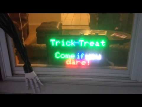

  • Halloween again - (4) Adafruit 16x32 RGB displays with Rayman's drivers.
