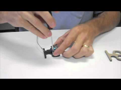

    Maddie,
    Will Parallax still offer the aluminum PING stands?
    Is the acrylic stand translucent so that the LED indicator on the PING will be visible?
    Thanks,
    Ron
    edited 2011-08-31 06:05
    Howdy Ron-
    Yes, the Aluminum Ping Stand is still available. This acrylic version is simply a lower cost alternative - gives you choices!
    The "Transparent Grey" Acrylic allows the LED to shine right on through - no light pipe needed!
    -Matt
