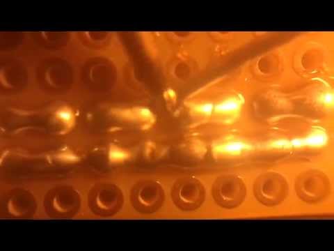

    The frustration that I would personally have with VBT would be with bridges forming that you wouldn't want. Did you experience any of that while you were putting the board together?
    I used to, but not anymore. I have a very sharp tip on the soldering iron, solder just drops off of it.
    Another thing that helps, is to do it in very small parts to let the solder cool off before melting it again.
    Made a small video of it:
    It's also much easier when you don't have a cellphone 2cm away from the board :D
    edited 2011-08-23 15:44
    Thanks for the vid. Thats a cool technique. Does the solder ever pop off the pads after it cools?
    Are there any issues with capacitance or RF or any of that stuff due to the fat sold conductors, or is it the opposite?
  • namochannamochan Posts: 7
    edited 2011-08-23 15:58
    Few of those look like they could, but none so far :D And I haven't had any problems with interference yet. I guess the solder isn't the best conductor around and it would be more proper way to put bus wire inside the solder like Andrew said.
    Then again, this is really fast way of doing it. And if you need to add, let's say a resistor on the line, you just need to use solder vacuum on 4 tabs and just drop it in there.
