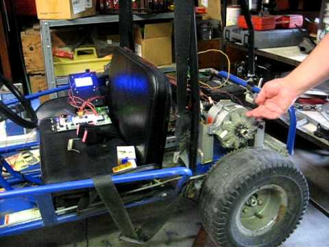

  • TappermanTapperman Posts: 319
    edited 2011-08-24 12:56
    kuroneko wrote: »
    Glad you got it working.
    Thanks for all your help, here is where that code went:
    pin 8 drives my FIELD switch and pins 13, 14 and 15 are the 3 phase signal used to drive motor with.
    Because of the way the IGBT's get power, I have to turn the bottom switch on now and then to charge the 1000 uF cap that powers the top IGBT boards (6 in all, 3 top and 3 bottom).
    Due to construction an output on pin 13-15 of 0, turns on the bottom switch ... and outputing a '1' turns the top switch on. changing the dira to input on any of these pins, prevents either switch from operating!
    ... Tim
