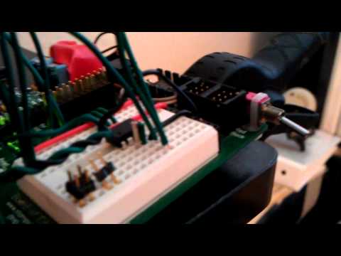

    One problem that is driving me nuts:
    If I change the HEX2 prefix to DEC2, then the clock looks right when I am setting it, but if I change the DEC2 prefix to HEX2 then the clock runs right. I don't get it...
  • CalMarinerCalMariner Posts: 64
    edited 2011-08-20 11:13
    I am on YouTube. Should I put a project video up?
    edited 2011-08-20 11:15
    Be that! :)
    Looks right vs. Runs right. Help me out.
    edited 2011-08-20 12:27
    Looks right: When I'm setting it, repeatedly pressing the "Hours" button (HBUT) makes the hours increment up. When using DEC2, the display will read out 1,2,3,4,...,10,11,12. For example, I set it to [12:59: A]
    Unfortunately, when the clock runs (Show_time), the display shows [ C:45: A].
    Runs right: When setting it, the time increments as follows: ...,7,8,9,A,B,C,D,E,F,10,11... However, when the clock is running using the HEX2 prefix, it looks and acts like a normal clock.
    I know that there is something I lack in comprehension. This is maddening.

    edited 2011-08-20 12:44
    Here is a short video introduction (available in HD):
