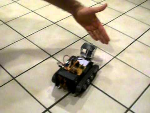

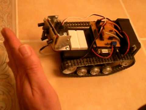

    edited 2011-09-11 18:05
    Here's a video of the completed phase one:
    For phase two I plan to add edge sensors so the tankbot won't drive off edges, as well as front and rear aluminum bumpers. I may circle back and build a second IR compound eye using higher quality phototransistors. The eBay specials I purchased are really non-linear in their response, so right versus left and up versus down are not equally responsive. I added scaling functions and some code to trim the last few bits, but it is still pretty twitchy.
