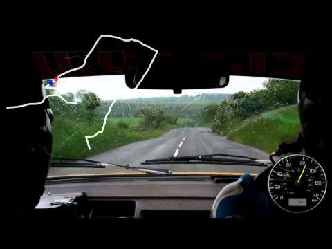

Is it possible for the propeller to have a 10 sec buffer of data, that when a trigger is tripped this 10 sec + live data is recorded to a sd card?
idea is for a gps data logger, that records your track data only when moving over a certain speed. then when you stop the log is closed
eg
gps incoming data ,add this live data to a 10 sec buffer purging old data out when new is stored then when speed > 30 mph record the 10sec buffer + all live data to a file then when speed drops to 0 for x secs close log file?
Thanks

  • Dwayne DibbleyDwayne Dibbley Posts: 63
    edited 2011-08-08 10:25
    mindrobots wrote: »
    Since you are going less than 30mph before your SD logging starts, your 10 second buffer could at most contain about 440feet worth of data. Depending on what type of accuracy you need, you can certainly play with your 10 second buffer. I'm not sure how many samples are in your 15K sample but by playing with teh sample rate and your needed accuracy, you may be able to have a lot more data in buffer before your start logging to the SD.
    i need at least 10hz output rate, so i can overlay my videos with the data like my example here:
    this data was recorded on the sparkfun logomatic ( as all i had at the time :) )

    Yes that's right so I get all the data from a standing start automagicly recorded, instead of recording all the time and starting stopping manually. so i would need some sort of circular logging for that 10 sec buffer to loop round.
    And yes I could simplify the NMEA strings but the current video overlay software imports NMEA strings, and I would need to additionally ( later ) create an import template for the new format.
    Thanks
