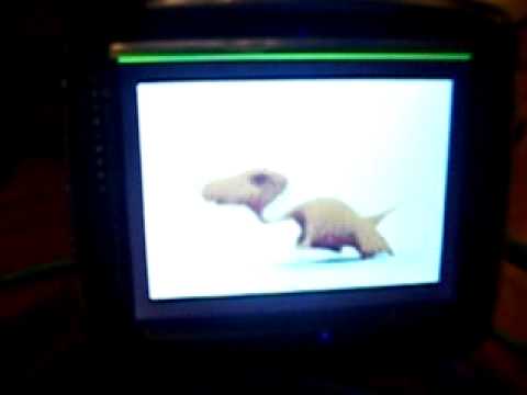

    Hi Loopy,
    So I am wondering if anyone has managed to run animated GIF or other animated file formats on a Propeller platform.
    I took your animated GIF from your avatar and put him on the propeller :)

    Sorry I didn't get a chance to write it up - I put that together at midnight after an 18 hour work day (my world is a waiting room full of crying children with earaches). But I have been able to vent in a most appropriate way on OBC's thread here http://forums.parallax.com/showthread.php?133472-Survey-What-gets-in-the-way-of-your-Propeller-projects
    I'll post the code when I get home, but the steps are:
    1) Grab the .gif file - right click and "save as".
    2) Download the video converter part of AVS4YOU http://www.avs4you.com/AVS-Video-Converter.aspx
    3) Open up the .gif (or any movie format really)
    4) Click on Edit along the top and there is an option to "export all bitmaps".
    5) Convert these using the vb.net program I have written (I'm at work at the moment but when I get home I'll post the source code)
    I've added a number of things to the vb.net code, including scaling and cropping and dithering. Test it first on single images before running the code to convert all the bitmaps in one go.
    6) Copy the .tvm file to an sd card
    7) Compile the movie player program. This is a hybrid of Baggers' 256x96 video driver and Kye's SD driver. Normally the video driver runs all the frames and then stops, but for animated GIFs I just put in a "repeat" in spin and then loop through the frames (23 frames).
    The hardware is a dracblade but it is overkill for this application as you don't need external memory etc. Any propeller will do - in fact for this sort of program all you need are 4 pins for an sd card and 3 pins for a TV.

    Two files attached.
    One is the spin player file - almost identical to the link in the post right above but with the filename changed and the repeat loop so it keeps looping
    The second is the vb.net program to process the files. I tend to run this from within vb.net rather than as the compiled program as I'm always changing things. unzip and if you have vb.net installed, double click "catalina.sln" and hopefully that will open the program.
    This 256x96 converter is in the "High Res TV" tab. Play around with single files first. Try altering the topx, topy and width variables. Sometimes the picture overlaps itself - that is a quirk of vb.net. Keep experimenting till it fills the screen the best.
    If you used AVS4YOU you end up with a series of bitmap pictures with numbers after them, eg loopy_01.bmp, loopy_02.bmp, so the bitmap root name is loopy_, and then you can add in the numbers. This automates the creating of the large movie file.
    This is all very experimental at the moment so please let me know if things don't work.
