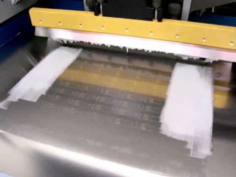

Yes, another new piece of equipment came 'online' today! - (actually yesterday, but my camera batteries were dead)...
Although, we've had this Machine for a while, Manufacturing has been so busy that we haven't had a chance to get it fired-up and connected to our PnP and Oven line. The Talent Pool in Mfring made it happen - Yay Mfring Talent Pool!
(Up until now, we've been "hand stencliling" - but no more - higher throughput and better quality!)
Visually, it's not really that impressive of a video. However, what it does for us is eliminates stenciling the panels by hand - which helps drive down cost and increases consistency and quality.

    Does it apply the solder paste?
    edited 2011-07-14 21:16
    @ Bomber - yes, exactly. It applies the paste/solder mix through a stainless steel stencil using those "sqeegee" thingy's.

    I seem to notice something ironic. The machine seems to take longer than I remember it being done by hand at my visit.

    Probably true, Bomber. The frequency of use is low, but when you stencil you better get it right. The machine provides an even pressure to properly distribute the solder paste.
    When our humans do this task only a couple of them have been able to master it, causing great frustration among the team or a dependency on a couple for this task. If it's not scalable, it's not mass production.

    The additional advantage is that the human who runs the machine can multi-process with it, which he could not do if he were hand-stenciling. So it does save time, given a fixed manpower figure.

    The manual method was on a table, with a manually operated hinged stencil frame. Each board had to be precisely placed (by hand) into an exact location, then the stencil lowered, then the squeegee picked up and wiped. Then the squeegee set down, then the stencil lifted up, and then the board lifted out of the device and placed on a table with a bunch of other "pre-stenciled" boards awaiting insertion into the PnP conveyor.
    With this machine the operator simply loads a blank board into a slot at the beginning of the production line, and (almost) never has to touch it again until it comes out the oven at the other end.
    So while the "wiping" action of the machine is certainly slower, the "overall operation" time is reduced, which provides more time for Quality checking, etc.
