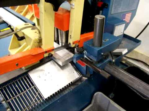

    Hey everybody-
    Here's the first step in the Motor Mount and Wheel Kit production process for Madeusa...
    -Matt

    I love to machine aluminum.
    More Pic's Matt please...
    P.S. Nice saw !!!!

    Do you Know if he used a template block, that is already the correct size, by placing it up against the blade (with the saw off of course) on top off the bar stock. He then could move the stop up to the template block and lock it into place, remove the template and bingo his first block would be spot on. No Waist. Just a suggestion.
    edited 2011-07-08 10:32
    ...template block...
    Nice idea! I'll forward that to our "Ace Machinist" -
    -Matt
    edited 2011-07-08 10:34
    P.S. Nice saw !!!
    No irony here. MadeUSA's first operation is being cut by a saw that's Made (in) USA...
    (big sticker on the right side of the machine, barely visible flag)
    -Matt
    edited 2011-07-08 10:52
    Hi Mr. Gilliland,
    Thanks for posting the video.
    What's that squirty stuff sprayin' about during cutting? Some sort of lubricant I guess, but what exactly?

    @davejames
    The "squirty stuff" is a coolant fluid that stops the heat generated by the friction of the blade from damaging the machine and ruining the blade.

    OK, understood - thanks.
    Is it typically water or is it a chemical concoction?
    edited 2011-07-08 11:54
    Hi davejames,
    (Right you are Bomber!)
    It's both a coolant and a lubricant. This is one of the variants we use. I think it's 3 parts water, 1 part "secret sauce".
    -Matt

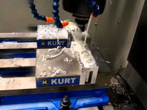

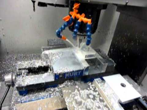

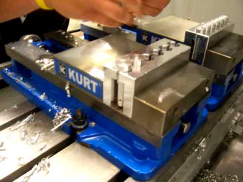

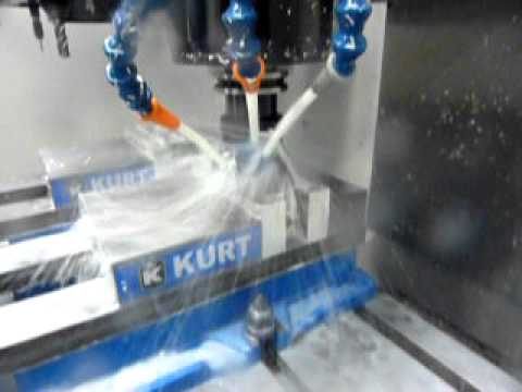

    Ok, so we deviate now to Ping Stands (getting low again). There are (10) of these little guys on every Madeusa.
    The Motor Mount block machining will have to wait 'til next week.
    Congratulations! You have Quadruplet Ping Stands being born right now!
    -Matt
