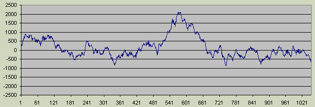

  • tonyp12tonyp12 Posts: 1,951
    edited 2011-06-27 17:35
    The grid uses a high accuracy clock somewhere and make small adjustments to itself
    to keep the daily ticks to an exact number.
    Short term is not so accurate, as this pic shows ppm error over a 17minute span
    edited 2011-06-27 17:41
