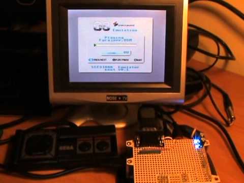

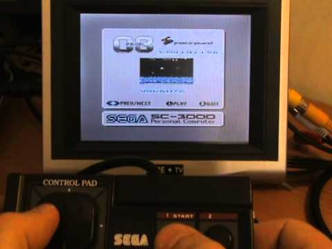

Hi! I was having some "rest" from the developing of VDP gfx II video mode ( I still have to implement the color table parsing ), when I decided to create a possible main menu.
The VDP driver starts with a tiny version of the JTCook Spintris tv driver, ( I decided to have a low resolution of just 160 pixel to fit in one cog ) . I've assigned a fixed cog number to run each tv driver: GFXII, Text and multicolor JTC drivers. The VDP switches them according to its registers combination.
The boot menu starts by reading graphic tiles from SD card, and reads also a tile table to show the main screen. The thumbnails of games are stored as binary raw files on SD card, and have their sequential code. The same code has been given to txt ASCII files that contain game names.
So when you scroll games, the boot menu loads from SD thumbnail and text of each game.
In this demo when you select a game, a VRAM dump is loaded and the VDP is configured to read proper VRAM locations. So the GFX II mode can show game a title screen, and the BASIC Level III can show main screen.
When you go back to the menu, the main graphic file is loaded again, and the video mode is swiched back.

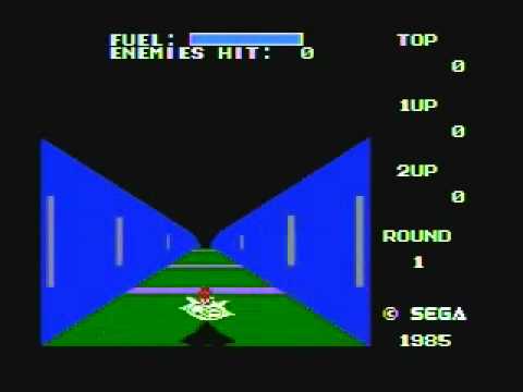

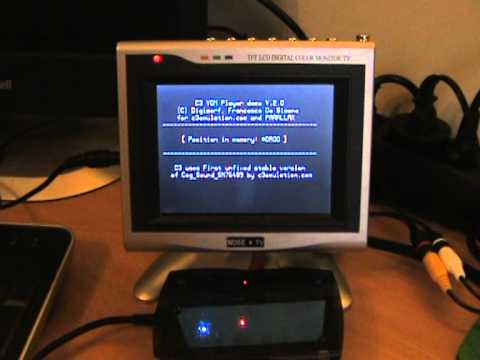

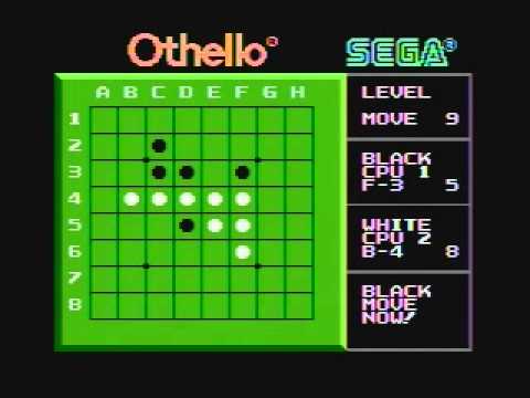

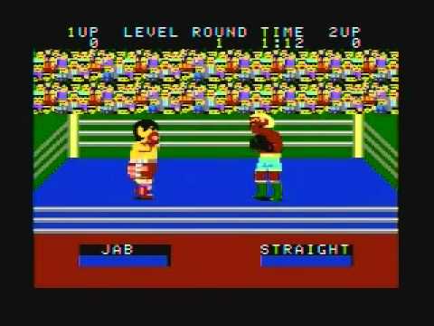

It's time!
Believe or not the SEGA SC-3000 emulation is running on PropC3 board equipped with C3Synapse!
I couldn't wait to show you some video captures from the W.I.P. version of the emulator running three games
Zoom909, Champion Boxing, Othello ( Reversi )
In the next days I will prepare a more detailed video, but now enjoy these short vdeos!

The emulated hardware eats a lot of memory. Since the C3Synapse has been released things are really better for this emulation
Think that 16kb of HUB memory are used by the TMS9928, the qz80 of Pullmoll has been customized for driving the C3Synapse and has been reduced a bit to save space.
Now the code of the PSG has to be reduced more to fit in the emulator program.
Then I have decided to split the IO handler in different little interfaces embedded on each emulated device. So the emulator hasn't any cog that handles the IO, in fact each emulated chip has it's own asm interface to handle access.
I will post a more detailed video very soon.
