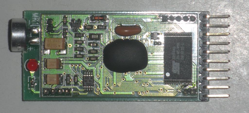

Late last November I bought a Say-It module and it worked great for a month, but then mysteriously failed when one component got really hot and then it only returned comm errors after that. Parallax sent me a replacement as I was within the warranty period. But I didn't try the new one until last night.
As soon as I plugged it into the app mod socket, I smelled frying circuits and the Say-it GUI couldn't communicate with it. When I pulled the module out of the app mod socket one component was hot enough to burn my finger:
Ouch to say the least. Next time when pulling a circuit that's starting to smell bad I'll grab it by the sides. Frankly I'm mystified. I don't know if the modules or prone to fail or I'm doing something really wrong.
I am sure I plugged it into the ground, 0, 2, 4,..., 5v row. I checked the app mod socket with my DMM and ground was at ground, 5V at 5V, and the pins weren't shorted to either. But when I plugged in the second one it failed right away. The BS2 seemed to work fine after each module failed, so I really don't think there was high voltage at the pins.
Here's a picture of the module:
The component which got hot is the top rectangular on the left which isn't quite square on its pads.
What is that component? Any ideas if I messed up or is that component shorted because it isn't on its pads right?

    That's a capacitor and yes, it's position on the pads could easily cause it to short to the resistor that is above it which would explain the "hot failure". I would recommend that you contact Parallax tech support as I would assume they will probably want to send it to the manufacture (by replacing yours)

    I usually keep one finger on the voltage regulator when I power up something new - just in case I've done something wrong. It may be low tech, but it is a great indicator and preventer of damage at the initial assembly phase.
    It could be that the capacitor is rated for the wrong voltage or that there is a solder bridge some place. I am sure Parallax is more than willing to work with you on this as they really want customers to feel complete satisfaction with whatever they sell.
    If I am seeing correctly, that capacitor certainly does look as if it isn't fully on the pads as intended. Something may have been positioned wrong in the automated assembly process.

    If that was a tantalum capacitor then it could have been under rated or installed backwards. If the capacitor is installed backwards they will fail like that.
    I haven't heard of any other modules with problems like that so it is probably isolated to a few odd modules that got through QC...
