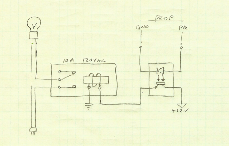

I've been "cog"jugating some ideas in my head that use A/C motors so today I experimented with controlling an A/C device with a Propeller.
I came up with an opto-isolated relay to turn a lamp on and off as an experiment. Here is the circuit:
Should I add resistors or diodes anywhere. It works fine as drawn but I've seen other similar circuits with pull up or pull down resistors and/or protection diodes. Are these needed and if so where.
Thanks in advance,
Paul
PS - before some of you guys rip me a new one, remember this is how I learn. :D
    edited 2011-03-19 20:36
    You need the resistor and a diode with anything, Propeller notwithstanding.
    See attached.

    That's easy enough! Thanks. I had a resistor on the Prop pin originally but wasn't getting enough current to the IR LED (homemade opto-coupler) so I took it off. Guess I should have put it back after I figured the rest out.
    edited 2011-03-19 20:44
    Well, DVM, I think it's better to activate the relay with the coil between +V and the collector, and the emitter connected to GND, instead, but I didn't want to force the issue. If you go that route, the diode should still be across the relay coil (anode to collector, cathode/band to +V.)

    edited 2011-03-19 21:00
    Can you tell me about the "homemade" aspect first?
    edited 2011-03-19 21:16
    In anticipation of your response --
    If the unknowing see relay coils in the emitter leg of an "opto" then they'll want to put them in the emitter leg of a transistor, too. They'll do so without regard to the coil voltage.
    In a "non-opto" transistor circuit, V_e is V_b - 0.7V; in the case of a Propeller V_e will then be appx 2.5V, it won't work and they'll marvel as to why (why?). V_e must be at least V_coil(min). If it's a 5V coil or a 9V coil or a 12V coil then it's not going to happen with the load in the emitter.
    So, I will teach with the coil in the collector leg always, fewer problems for "tinkerers."
    Relays are "isolated" anyway. The contacts are away, separate from the coil/s, especially if/when they have UL approval. I don't get the obsession with "optos" and "isolation" and "protection"; it's like a lot of stuff around here, superstitious behaviour.
    PE -- I'm "talking" NPN.

    A transistor is a current operated device. A small input current controls a (much) greater output current.
    If you want to try it with a NPN, and I encourage you to do so, please note the attached circuit.

    I agree with pretty much everything posted here except the "I don't get the obsession with "optos" and "isolation" and "protection"; it's like a lot of stuff around here, superstitious behaviour.". The optos provide additional protection to the driving circuit and allow the grounds to be isolated as well, thus avoiding potential "ground loops" and noise pickup.
    Consider what happens if the transistor driving the relay should short out. You now have the output driving that transistor connected to +12V through a low value resistor. If you have a 1K or larger resistor between the prop pin and the base of the transistor the prop should survive....probably. What if that is a 24V or 48V relay? What happens if the 12/24/48V regulator shorts and applies a considerably higher voltage to the relay coil?

    Not much an idea here but if the opto LED is on permanently why does the optos transistor not burn as the relay coil becomes a short. Are we relying on the power handling of the transistor and the resistance of the coil?
    edited 2011-03-20 10:37
    Heater. wrote: »
    Not sure if this question was directed at me, but here goes. If the coil shorts the opto transistor will almost always burn out. Since there is an insulation layer between the opto led and the opto transistor good for about 4KV nothing will happen to the led or it's drive circuit (the prop pin or whatever). Once you replace the relay and opto isolator you are back in business.

    What I meant was that when the optos LED is on the transistor is conducting. The only limit to the current is the resistance of the coil. So presumably one has to be sure the resistance of the coil is enough to limit the current and avoid burning the optos transistor.

    Yes, the coil current must be low enough for the opto transistor to handle. For relays that require more current than the opto transistor can provide an additional drive transistor is added. The opto transistor and drive transistor are often connected as a darlington pair. As always, a suitable diode is connected across the relay coil.
