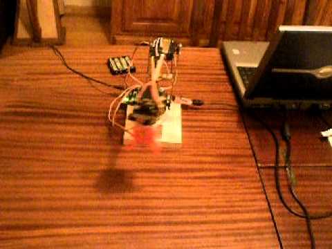

    So here's the completed ulna:
    Here it is attached to the servos, the humerus, and the base:
    I started with the humerus and thought of using silver solder with tubing after I built it. I used that for the ulna and liked the way it came out, so I may build a new humerus using that technique. But I'm going to resist this until I get it working. You may have seen me post some floating point code in the Propeller forum. That's part of an inverse kinematic program I found in C that I gave up trying to port to PBasic. But Spin and the Propeller look like they can handle it.
    1024 x 826 - 74K

    Sweet, I like the small size! From previous postings, you know to keep it lightweight and use smaller/lighter servos as you go farther out towards the gripper. It's all too easy to make a heavy, pendulous arm with jerky motions and very small payload capacity! Countersprings are also helpful sometimes, but you have to design those in as you go.
    Can YOUR Tower of Hanoi video be far away? It's a rite of passage for any arm builder! :)http://www.youtube.com/ercost60#p/u/12/-Z8lTSX4PHs
    edited 2011-03-13 14:14
    Erco, sweet tower of Hanoi video.
    Yes, I've built two lego robot arms and the first smaller lighter one worked better. I got overly ambitious with the second one and ran afoul of it either being light but not stiff, or being stiff but too heavy. So with this one I picked a size I was pretty sure would work. I'm looking forward to trying Tower of Hanoi as the first arm's gripper wasn't suitable for anything other than Lego bricks.

    After a month of distractions on other things which are generally known as life (i.e work, parenting, family, etc). I finally got my inverse kinematic transform working! So I put together a motion script of the arm solving Air Tower of Hanoi. It's what robots do instead of Air Guitar!
    Let's just say inverse kinematic transform bugs would make a pretty interesting out take reel if I had the presence of mind to video tape them.

    Sa-Weet, Martin_H! Theoretically, anyway! Let's see some real disks get moved around soon. Make 'em lightweight to minimize dynamic effects; your arm is moving nice & fast. My cheap little arm had some shoulder shudder, so I programmed it to move slowly & stately: http://www.youtube.com/ercost60#p/u/14/-Z8lTSX4PHs
    edited 2011-04-06 18:42
    Erco, thanks. I shall work on the posts and disks as soon as time permits.
    I never noticed the shoulder shudder on your arm, but watching the video again I see it ever so slightly. Do you think it's related to gearing in the servo or just a large rotational inertia?
    edited 2011-04-07 00:04
    Right on both counts, plus I didn't do any velocity ramping (decelerating) there. I rushed that code back then to "git 'er done" but now have it operating more smoothly, with ramping and damping. I have unlearned much that I have learned...
    edited 2011-04-07 00:23
    Hey, virtual Hanoi Brother: there may be a movement error in your sequence. You move disks 1 & 2 sequentially to the far left post properly, then you move disk 3 to the middle post properly, then at ~40 seconds, you drop disk 1 on top of disk 3 in the middle instead of going to the far right post. Let me know if I'm going senile early...
    One of the ToH descriptions I read says that disk 1 (the smallest disk) gets moved every other time. Further, it always moves one position in the same direction, except when it jumps back to the beginning. For instance:
    left center right left center right etc or right center left right center left etc...
    Since you're doing inverse kinematics, this may be an easy pattern for you to code.
    edited 2011-04-07 06:28
    I quickly used three pieces of paper and twice followed the virtual post to post moves. The solution does move a three disk stack from our right to our left, and moves the small disk ever other time. It looked to me like the small disk moves across the three posts in the same direction, hits an end post, and it reverses direction. But with virtual disks and shadowing moves it is possible I missed something. It will become more apparent when I switch to real disks.
    You're correct that inverse kinematics will make fixing any glitches like that simple. The coordinates of the moves are all computed, at the moment the only hard coding is the post to post move sequence (1 to 2, 2 to 3, 2 to 3, etc). I'm going to add code to generate that, but I didn't want to deal with recursion in Spin just yet. I'll post the code when I am done.
    The ultimate one plus would be adding some kind of sensor to the gripper, have it count the disks, and solve the problem in the general case for any number placed on the first stack.
