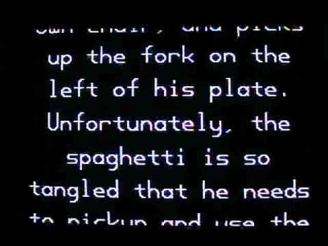

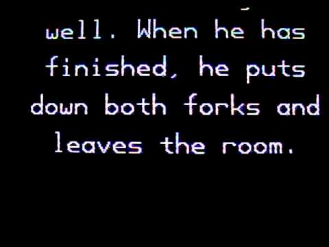

A quick fun exercise demonstrating the classic dining philosophers problem which was formulated by Edsger W. Dijkstra and Tony Hoare.
Five philosophers spend their lives thinking and eating. The philosophers share a common dining room where there is a circular table surrounded by five chairs, each belonging to one philosopher. In the center is a large bowl of spaghetti, and the table is laid with five forks. On feeling hungry, a philosopher enters the room, sits in his own chair, and picks up the fork on the left of his plate. Unfortunately, the spaghetti is so tangled that he needs to pickup and use the fork on his right as well. When he has finished, he puts down both forks and leaves the room.
The dining philosophers problem, while it seems very simple, allows to study different issues of concurrent programming, such as resource starvation and deadlocks.
Here is video visualizing the dinning philosophers problem.
In attached archive find the code. The code is a modified version of the code used to create the above vide. The modificaions were made to model different behaviors of the philosophers:
1. Random - the philosophers think for random time, then wait for their forks, then eat for random time
2. Lazy - the philosophers become lazy, they do not think, and always hungry :)
3. Sync - at a certain moment all philosophers decide to enter the dining room.
These behaviors demonstrate different situations that can occur in cuncurrent programs
The program outputs video on pins 12..15 Have fun!
